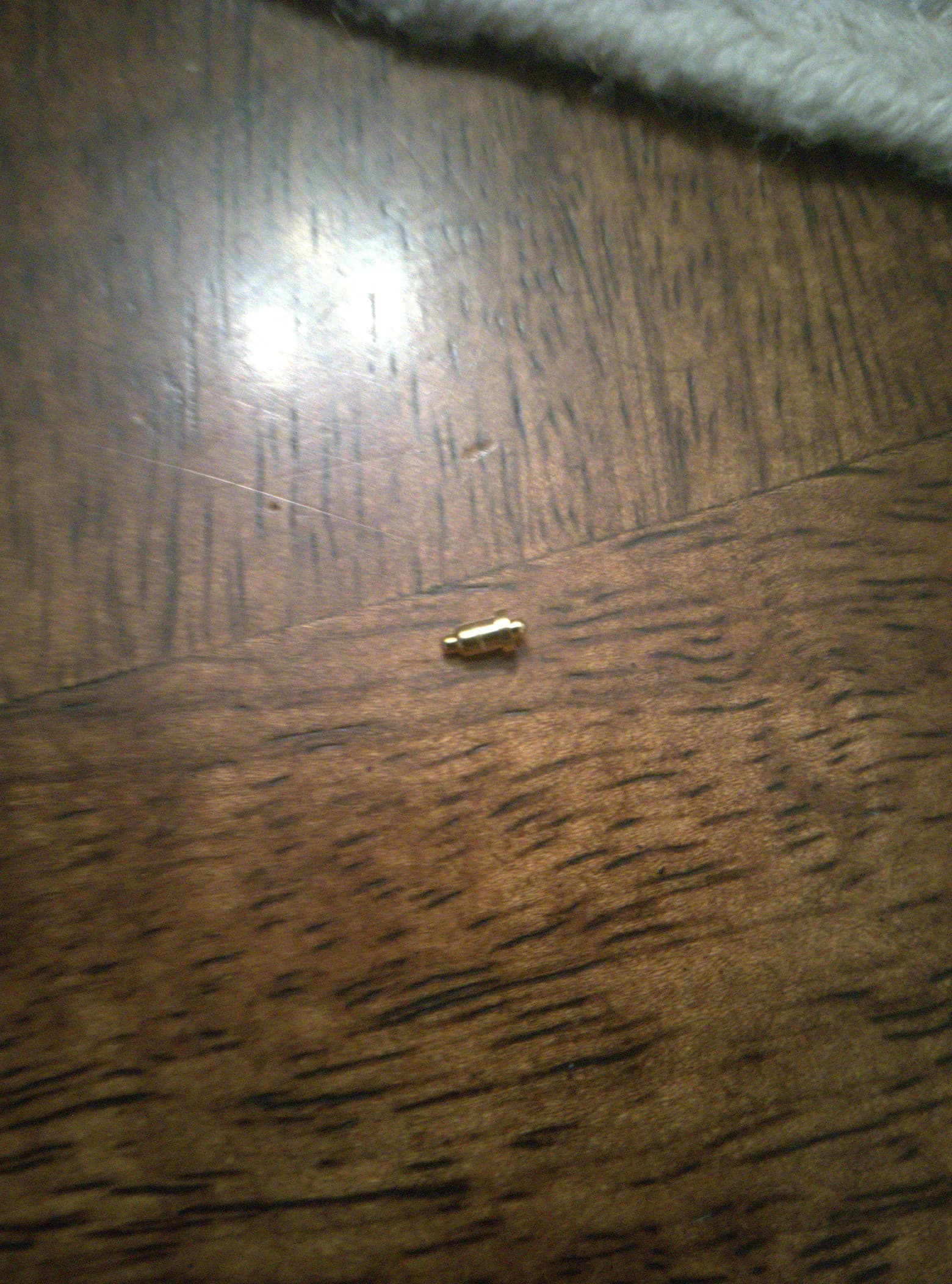

Loose thing inside my phone
I took apart my Librem 5 and there was a loose thing rolling around inside.
What is this and where is its appropriate location?

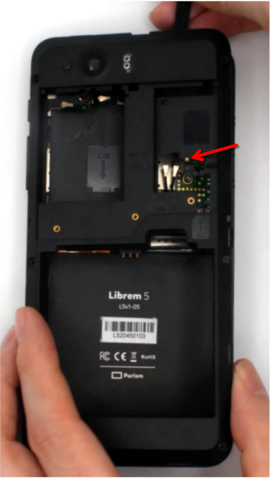

There are three golden pins. I suspect it is the one near the Wi-Fi/Bluetooth module:
The one near the wifi board is the only one I’ve had fall out when taking my phone apart. It is a little tricky to put back, but not too hard.
@Dlonk did you find where it goes?
I saw those when taking my phone apart. Here is one of them (image taken from Chassis - Purism user documentation ) :
There was at least one more later on, but I can’t remember where, and I’m not going to take the phone apart just to see, sorry :sweat_smile:
Nah I put it in a ziploc bag and left it off to the side, and put the phone back together because I was busy. So I appreciate the image! I need to open it up and put that back in.
Other images are available in and from the topic that I linked above.
