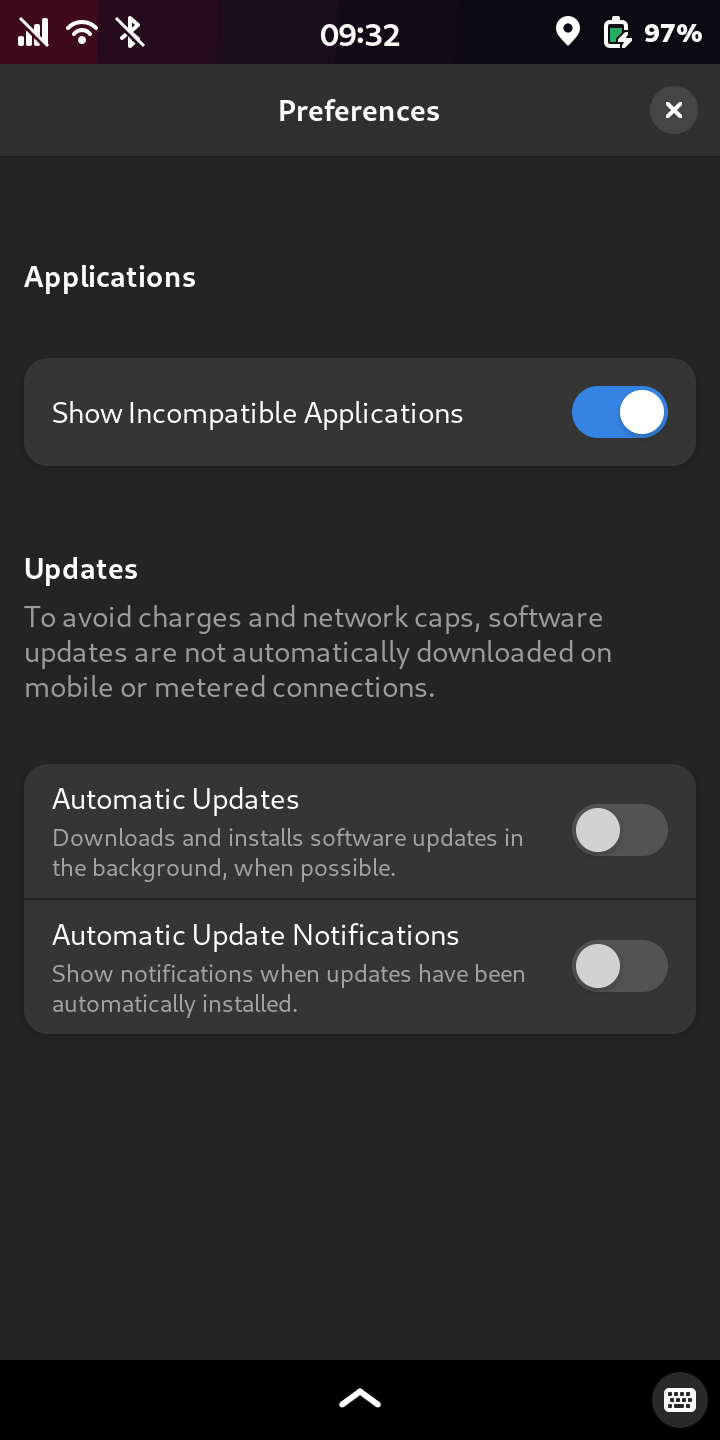

The software app references “metered connections” in the context of using automatic updates:

Do you have automatic updates enabled? If so, maybe that’s where the block originates, based on the warning in the above screenshot.
And I guess the software app is just making a judgment call that all mobile data must be metered or expensive. Perhaps unreasonably.
