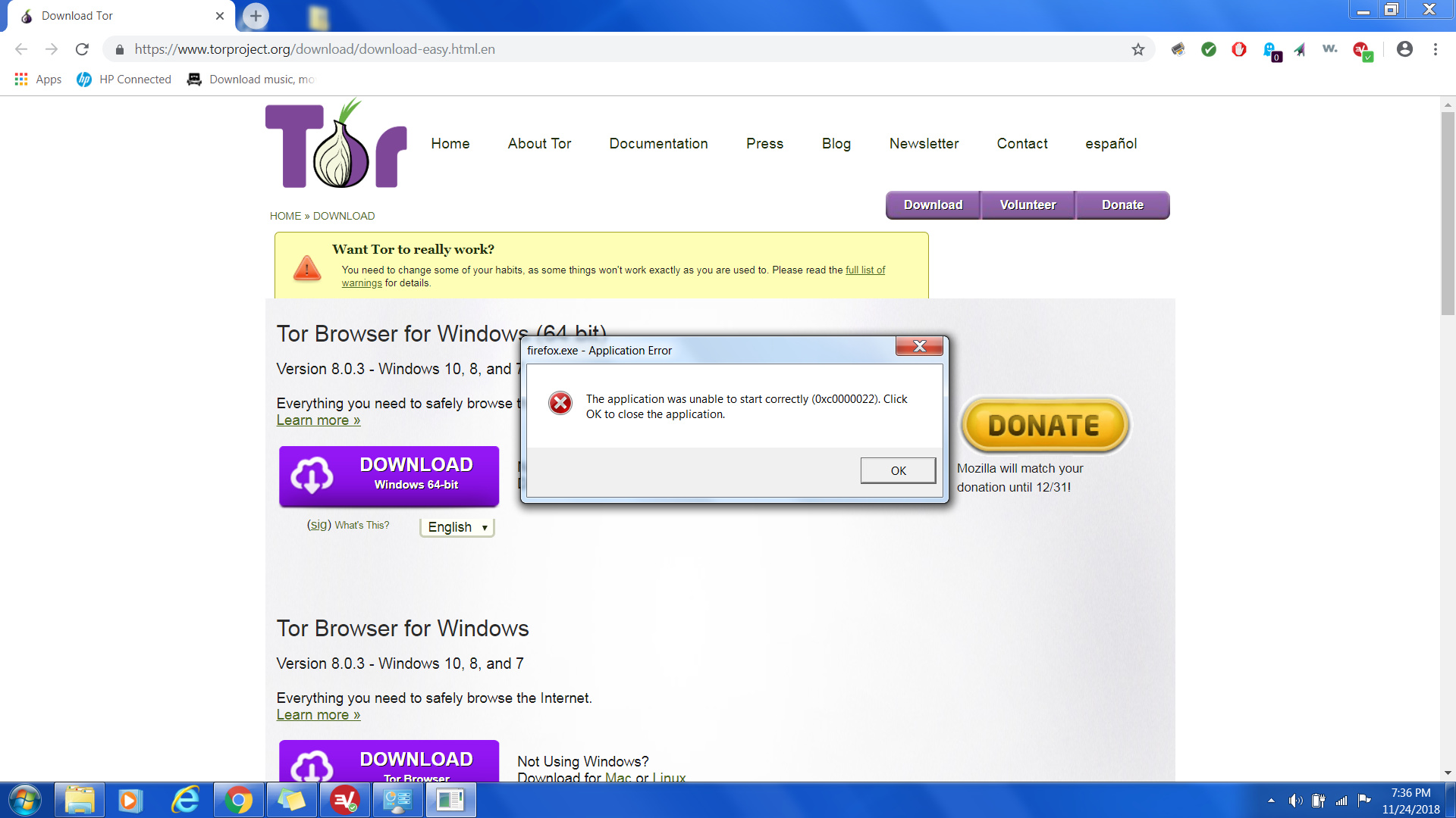

anybody having this issue? tor will not open anymore
