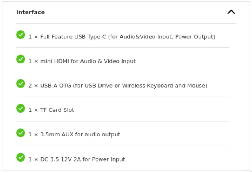

After a month I am still using the X Mini. The smaller size and lighter weight meant it was the dock I chose to take with me on a road trip.
I prefer the smaller size and the main downside (500mA charging) hasn’t turned out to be that limiting. It maintains the charge of the Librem 5 enough while using it, and I honestly don’t tend to use my this laptop mode for multiple hours on end. Even then I could easily plug it into the 20,000mAh power bank we sell now that I got a 3rd party USB-C->Barrel adapter.
For the other downside (keyboard layout) I found the odd | key placement doesn’t bother me all that much. Have I mistakenly hit Del when I meant to type |? Yes. But then I just find | in the new location. I have to say that the X Mini is definitely more comfortable to use in “tablet mode” compared to the 360.

While I prefer the X Mini’s size, the screen is inferior in crispness and quality compared to the nexdock. Switching back made that abundantly clear. Secondly, the X Mini only provides 500mA charging, which means the Librem 5 slowly drains. This isn’t a big deal for home use, however if I were at a conference, one of the advantages of using a dock is that I would be extending my Librem 5 use because it would be charging the whole time.
