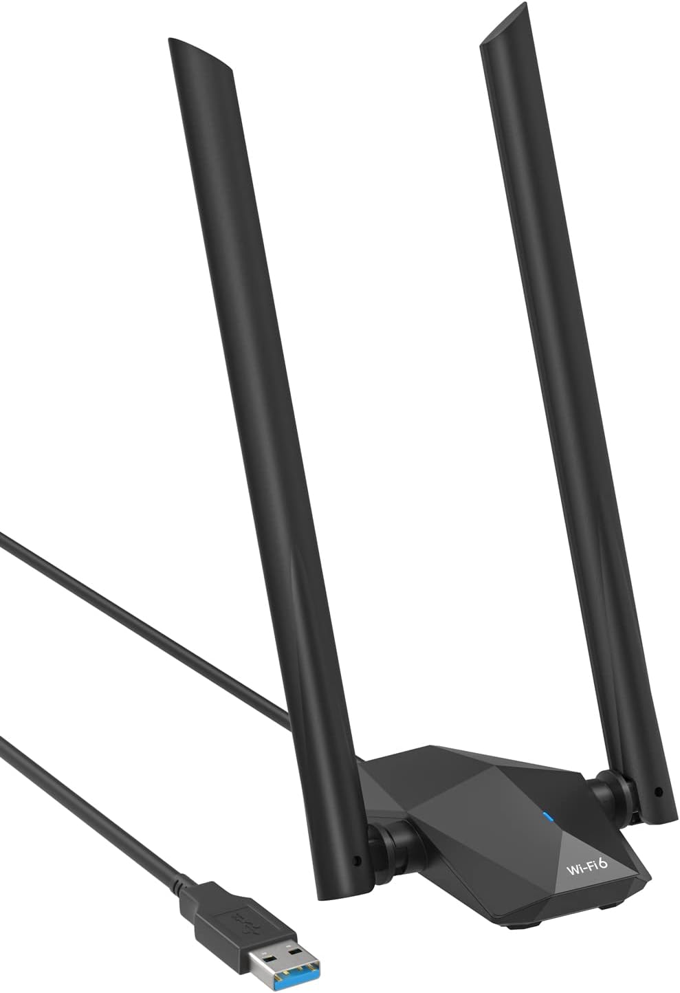

With my card (8852bu), there is no firmware loaded
sudo lsof |grep -i 8852|grep -i firmware
Password:
For this reason I think works with gnu kernel but I will try soon for a confirm
Tested, works fine.

Consider the card is this one, and seems need this firmware rtw89/rtw8852b_fw-1.bin (marked by debian packages as non-free)
as you can see it load without no problem in kernel 6.16.12
Now the question is: if require a non-free firmware why the Gnu kernel allow this firmware?

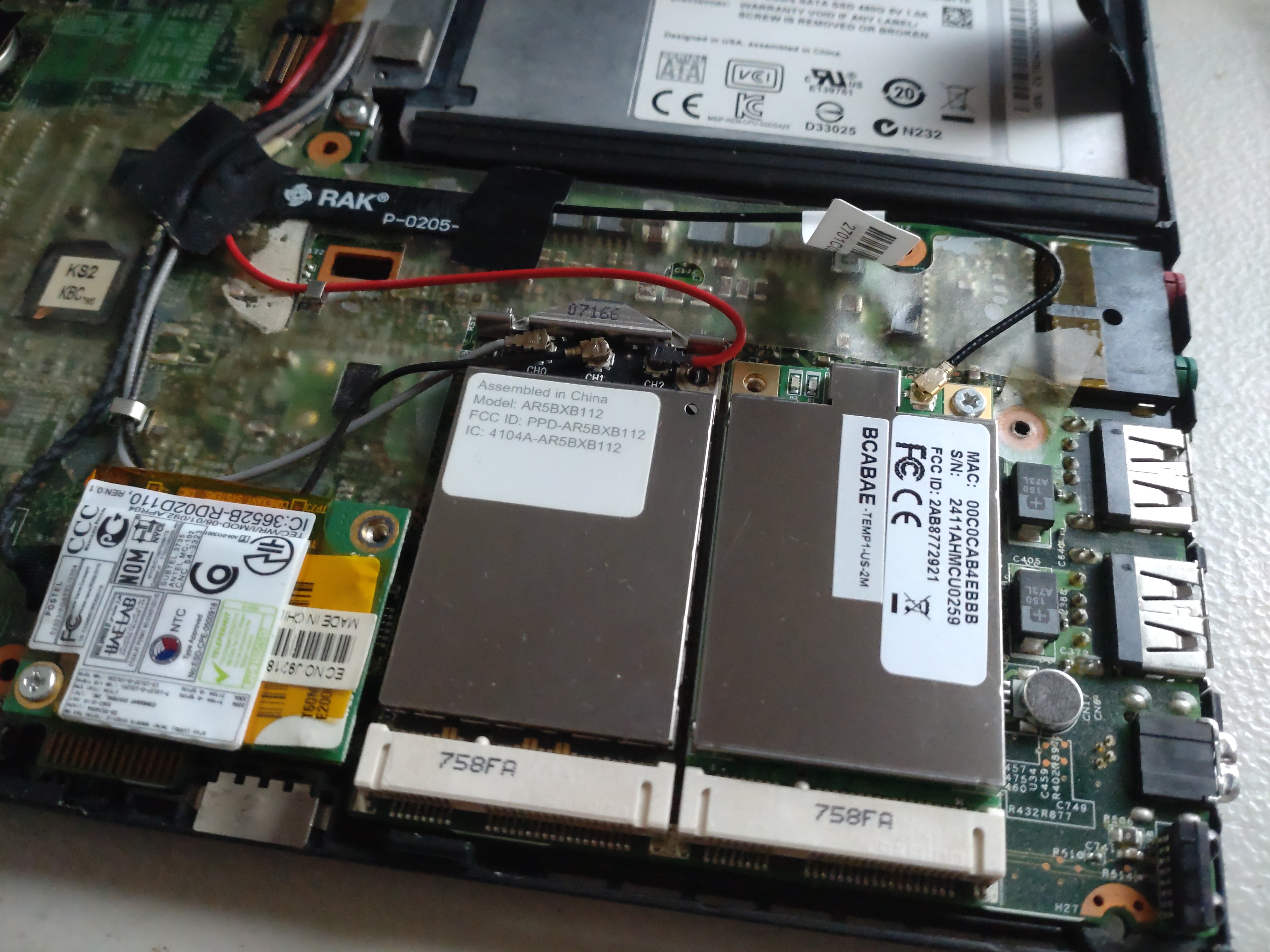

Meanwhile: anyone know a decent wifi card pci-e or usb which load without blobs?
I use on Raptor Alfa AWUS036H, but there is another gnu superstar: AWUS036NHA which i have this controllers too. There is another much better: Atheros QCNFA222
There is another chip from newracom that it do not need firmware for 802.11ah which is new wlan, so i will move to this controllers on all my computer including the Librem5 as a new module comming to enable to L5 to newracom chip. The problem with 802.11ah is that it need new infrastructure to work, it need patches to wpa-supplicant and build the driver, so it not plug-to-play.
So thank to boom-list and opensource most controller move the opensource-blob to host which is super ridiculous.
Both free software modules. Righ → module is Newracom pci-e chip on IBM X60.
The most exciting to me is that the new module that is coming is newest chip from racom and is compatible with the Librem 5. OMG i can not wait.

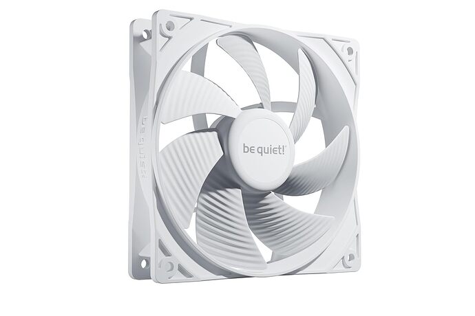

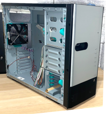

I want to replace the rear chassis fan with a more silent fan, but I don’t know the size, 140mm or 120mm?
The answer is:
140mm 6pin
120mm 4pin
Asus Kgpe-d16 support 4 pin, so I order this one
and two passive coolers from ebay, if IF they arrive I can start the build of my workstation in 2026.
And I will report if works fine. Meanwhile I remind this bug in old asus motherboards

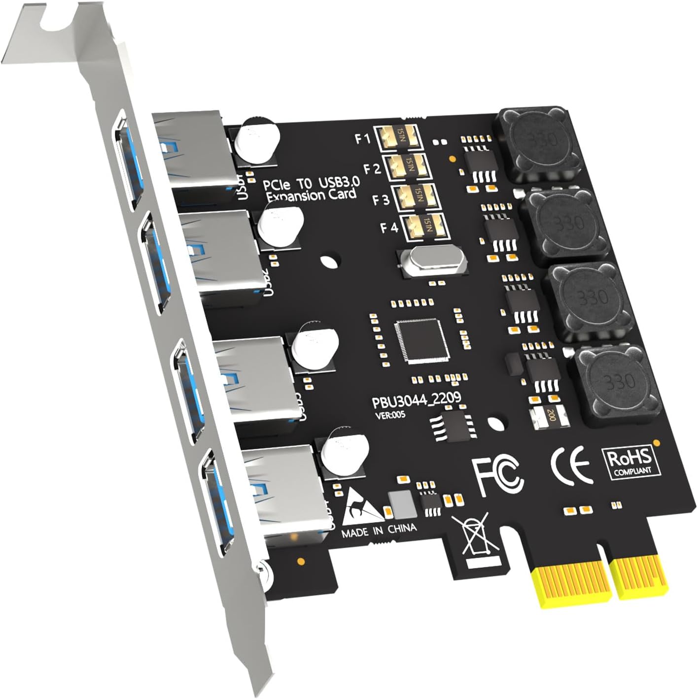

A question about usb-3 for asus kgpe-d16
This one
will be require proprietary firmware?
Meanwhile an idea to prevent to buy hardware and will discover (too late) it require proprietary non-free firmware.
wget ``https://linux-libre.fsfla.org/pub/linux-libre/releases/6.18.2-gnu/deblob-6.18
You want to know if a controller usb3 will require proprietary firmware? In this example is renesas
grep -i firmware deblob-6.18 |grep -i renes
reject_firmware drivers/ufs/host/ufs-renesas.c
announce USB_XHCI_PCI_RENESAS - “Support for additional Renesas xHCI controller with firmware”
reject_firmware drivers/usb/host/xhci-pci-renesas.c
reject_firmware sound/soc/renesas/siu_dai.c
In this case the answer is yes and you will avoid to buy hw with this chipset :slight_smile:
