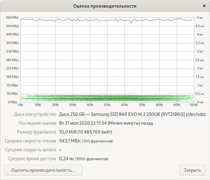

Thank you so much for SSD performance upgrade!!!
