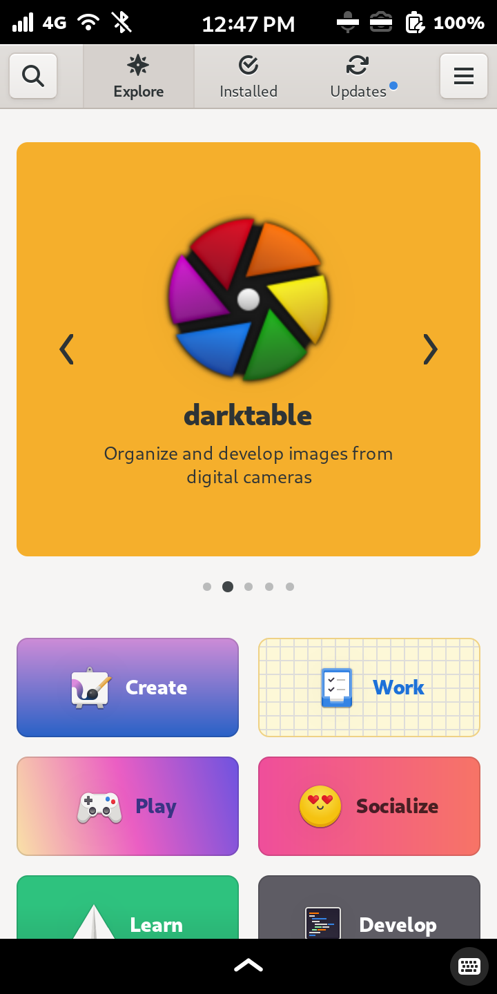

PureOS Store
`software.pureos.net`
PureOS Store landing page opens but no software lists in any of the categories.

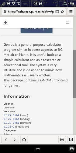

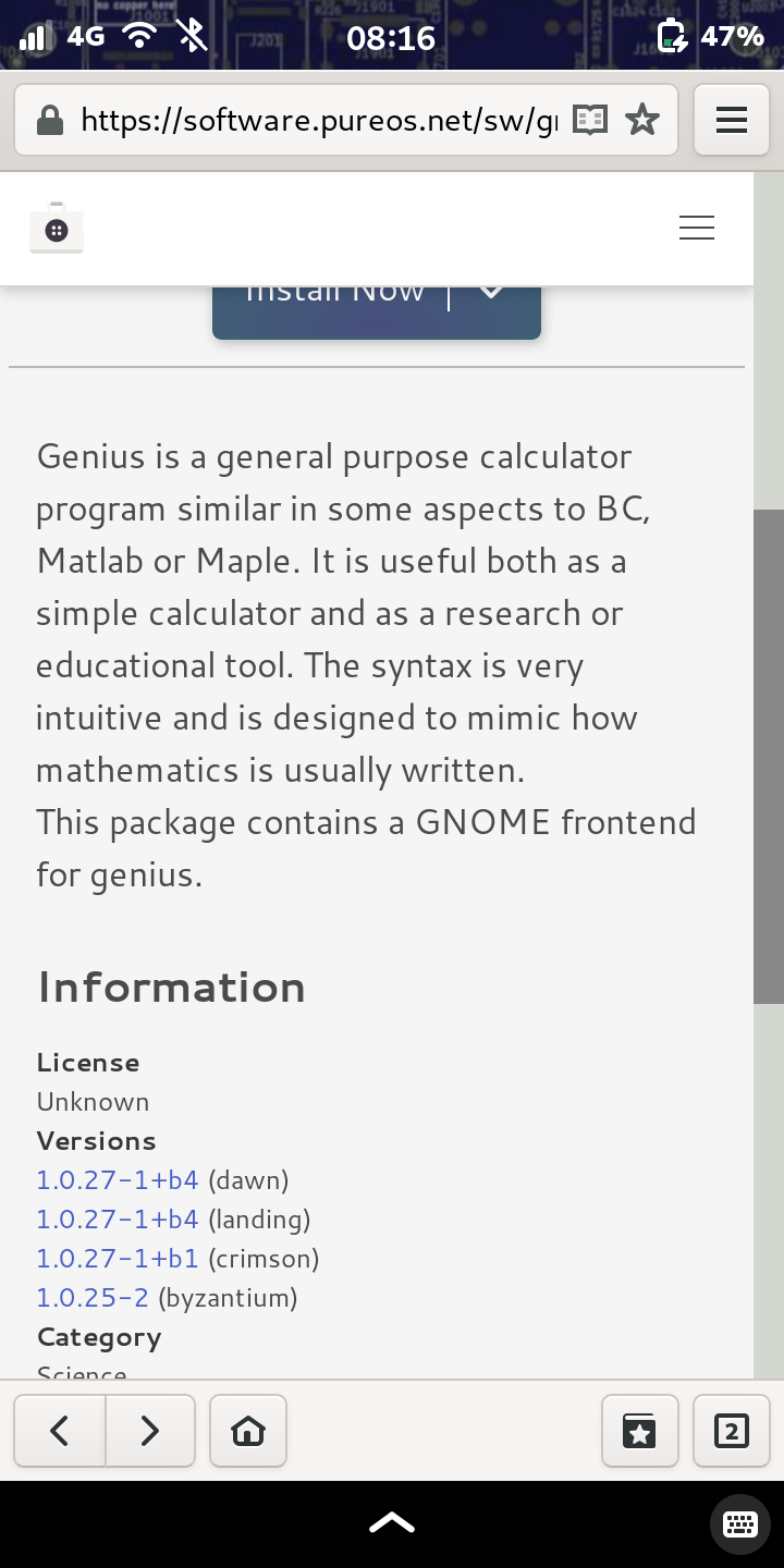

So imagine you found the tool you want to install on this Genius Math Tool page.
At the right, under “Information” you see versions:
I assume that you are on the default PureOS version, which is currently Byzantium. Click on the Byzantium version to get more details. You see now:
The gnome-genius in the screenshot above is the package name. This name should be spelled out exactly as written there, without any typos and exactly with dashes etc. as written there. To install this package via the command line use:
sudo apt install gnome-genius
You will have to provide a password (your Librem 5 pincode) and the “Genius Math Tool” will then be installed. You are finished with the terminal now.
Note that “Genius Math Tool” is only visible in the application icons if you clicked “Show All Apps” at the very bottom of all app launch icons, because “Genius Math Tool” does not really fit the window of the Librem 5 and is therefore not marked as a “Mobile Friendly App”.
I tested the procedure above on my Librem 5, and I do not want to keep “Genius Math Tool” on my Librem 5, so I remove it with:
sudo apt remove gnome-genius

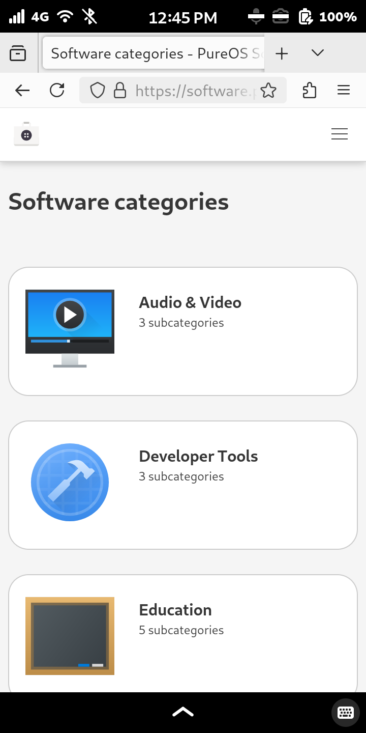

There is a huge difference between the software.pureos.net and the link in the L5 PureOS store.
To see what I mean, please try this.
Go to software.pureos.net.
Click “Utilities”
Click 1st item in Row 1 2nd column “Metadata Cleaner”
Click on “Install”
Now click the back icon (<)
See what I mean? The software.pureos.net landing page changes to the PureOS Store version of empty categories. if you watch closely, when clicking the BACK icon, there is a flash of the PureOS Store landing page version.

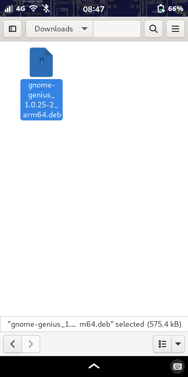

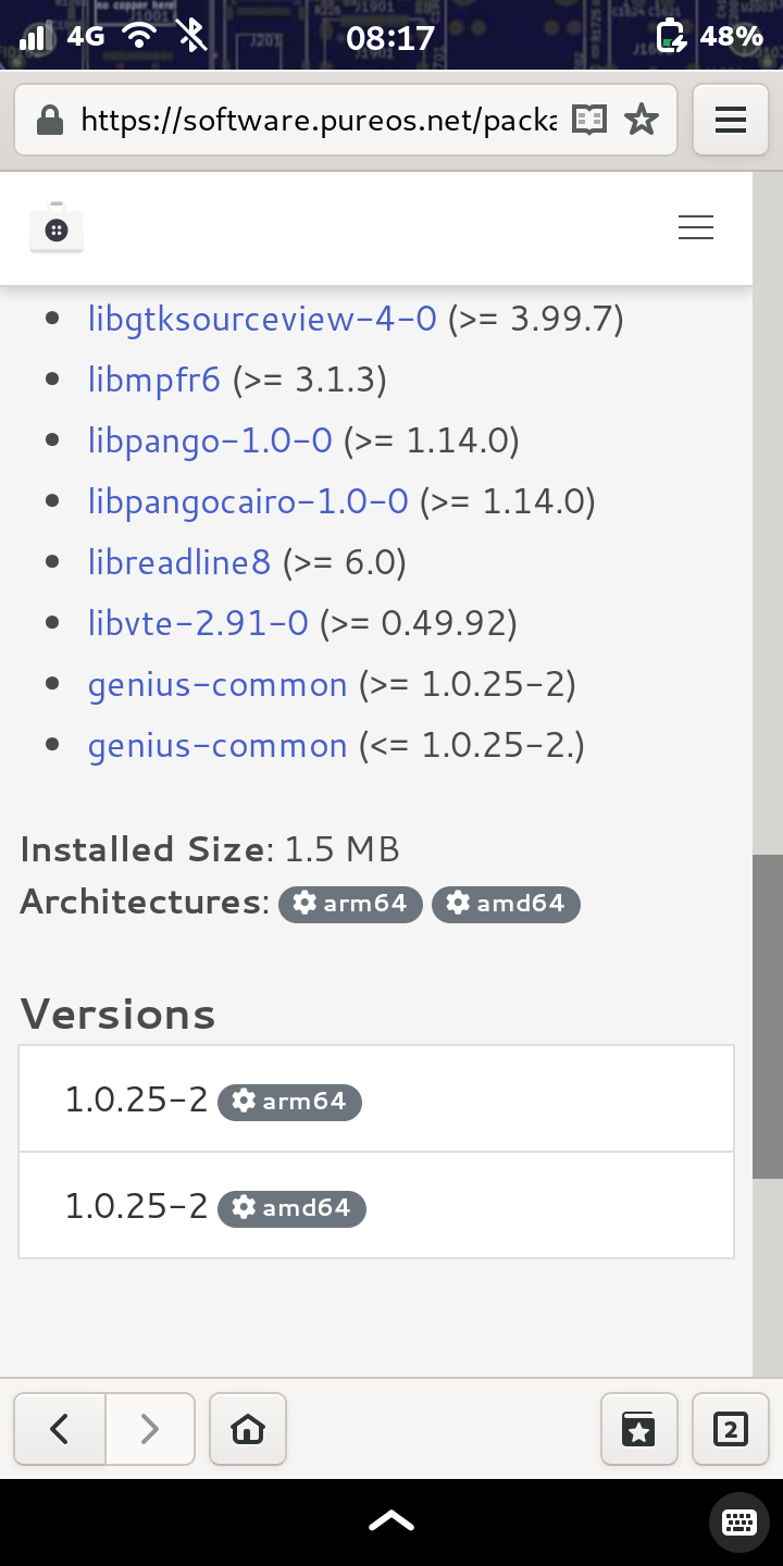

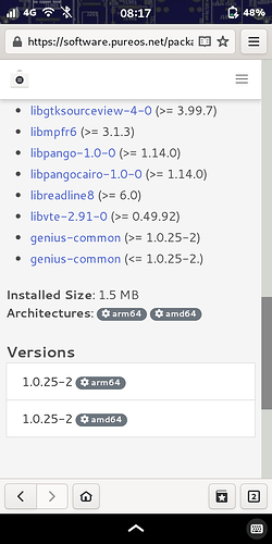

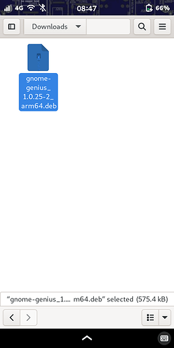

  2. (More complicated method) On the website, instead of clicking “Install Now,”
  • scroll down until you see the actual package versions:
  • click on the package number labeled “(Byzantium)”, which takes you here (and note all the required dependencies listed):
  • click on the “arm64” version; the Librem 5 is built on 64-bit ARM architecture). The .deb package (i.e. Debian package, because PureOS is based on Debian Linux) will be downloaded to your Downloads directory:
  • install the downloaded .deb file using commands in the terminal. Here’s a very short tutorial from Ubuntu Linux (another Debian Linux derivative).
    But… You will need to first install the entire list of dependency packages. [EDIT: Actually that one “arm64” button next to the word “Architectures” might install the whole list of dependencies at once, but I haven’t tried, so I don’t know for sure. If it does, then proceed to
    the “arm64” version further down for the actual app to be installed after the dependencies.]

There do seem to be multiple issues Sharon is having here, right? One being the PureOS store app on the L5 is buggy and then another that the list of apps appearing in the PureOS store is not the same as the apps appearing on software.pureos.net website.
But isn’t that second one more of a “works as intended” thing? The PureOS store app is only showing apps that are marked as “adaptive” to prevent the average user from installing something that Just-Doesn’t-Work™ on a small screen or without a keyboard or mouse.
Then on top of that, though, is the issue that there are apps visible on software.pureos.net (like the Metadata Cleaner example – I tried it) that can be installed on an L5 despite not being marked as “adaptive” that seem to work on a mobile device just fine. OK, so that’s actually three issues, isn’t it – the third being that there are some perfectly fine mobile apps that aren’t properly marked as mobile friendly and therefore don’t appear in the PureOS store app?
Fixing #3 sounds like it would require a hand-audit of entire repositories to install everything and adjust metadata to ensure that the desktop-only/adaptive flag is set correctly for the latest version of the package. At least it’s NMP, I don’t have repo write privileges.
(Also, probably a typo in the first post, but I definitely caution anyone against installing “Genius Meth Tool” unless you want some serious dental issues and other health problems.)
Correct, except I would say, both contain all the same apps, it’s just that…
… it’s worth noting that the search function in the app can access everything else in the repo (same as on the website), even if a lot of apps won’t be adaptive. Some will be, but as you say, won’t yet have been marked as adaptive, i.e.:
