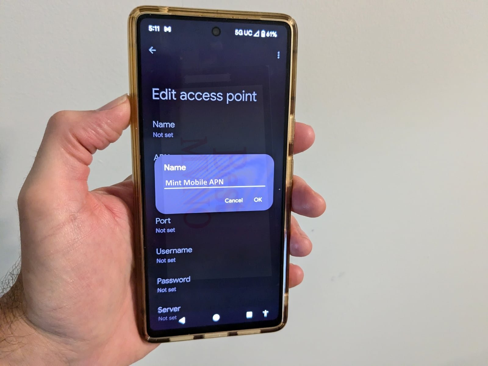

Can anyone comment on the accuracy of these APN settings for mint?
I can’t seem to find a combination of settings that results in a “network status” (as seen in “modem details”) other than “Not Registered”.
Mine (on android) is:
APN: fast.t-mobile.com
MMSC: http://mms.msg.eng.t-mobile.com/mms/wapenc
MMS: 310
MNC: 240
APN Type: default,supl,ia,mms,xcap
APN Protocol: IPv6
APN Roaming Protocol: IPv4
