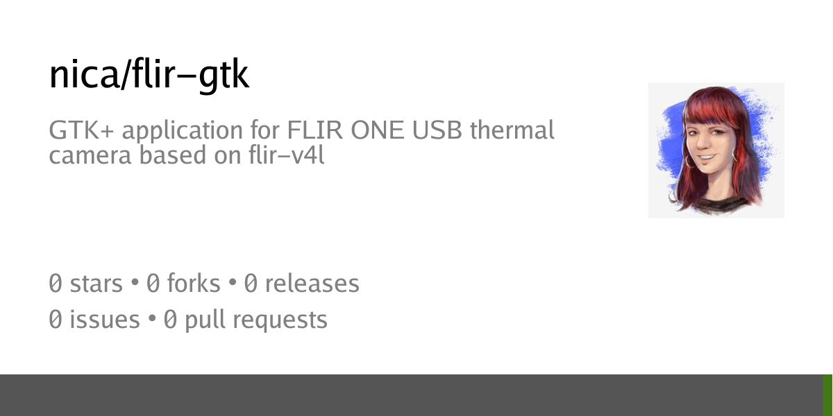

Built-in FLIR Lepton 3.5 thermal sensor.
Will be first-in-the-world in professional gnu devices by Purism. :wink:
What is the application of the thermal sensor? Why would I want higher price, higher complexity, higher weight, and higher energy consumption in order to have this sensor packed next to everything else?
Thermal scanner, this help to troubleshooting a lot things, things that the human eye cannot see but you will with a Fir Purism device. : )
Good question.
The poster specified “FLIR Lepton 3.5” which is a product name rather than a device type. FLIR is an ancronym coined by the maker of the “FLIR Lepton 3.5” and stands for “Forward Looking Infra-Red”. Teledyne FLIR sells their products mostly to government law enforcement: border patrol, surveillance, search and rescue, security camera, grow-light drug grower detection, …
Personally I can’t imagine why one would want it integrated into a phone. That said, for geek-out uses there have been raspberry pi boards incorporating these. [From Teledyne FLIR themselves see https://www.flir.com/developer/lepton-integration/lepton-integration-raspberry-pi/ ]

I think the IR sensor is more of a novelty thing. For the times you would use it couldn’t you use a USB sensor and just plug it into the L5? Like I said before, the biggest issue is refining what we already have. Power management is top priority I think because it’s a bit too reliant on being close to a power source to feel like you can spend the whole day on a charge. And other refinements like the gps/camera/bluetooth, that all needs to work better, mind you a lot of that is software development and not hardware.
