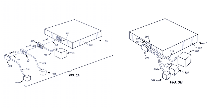

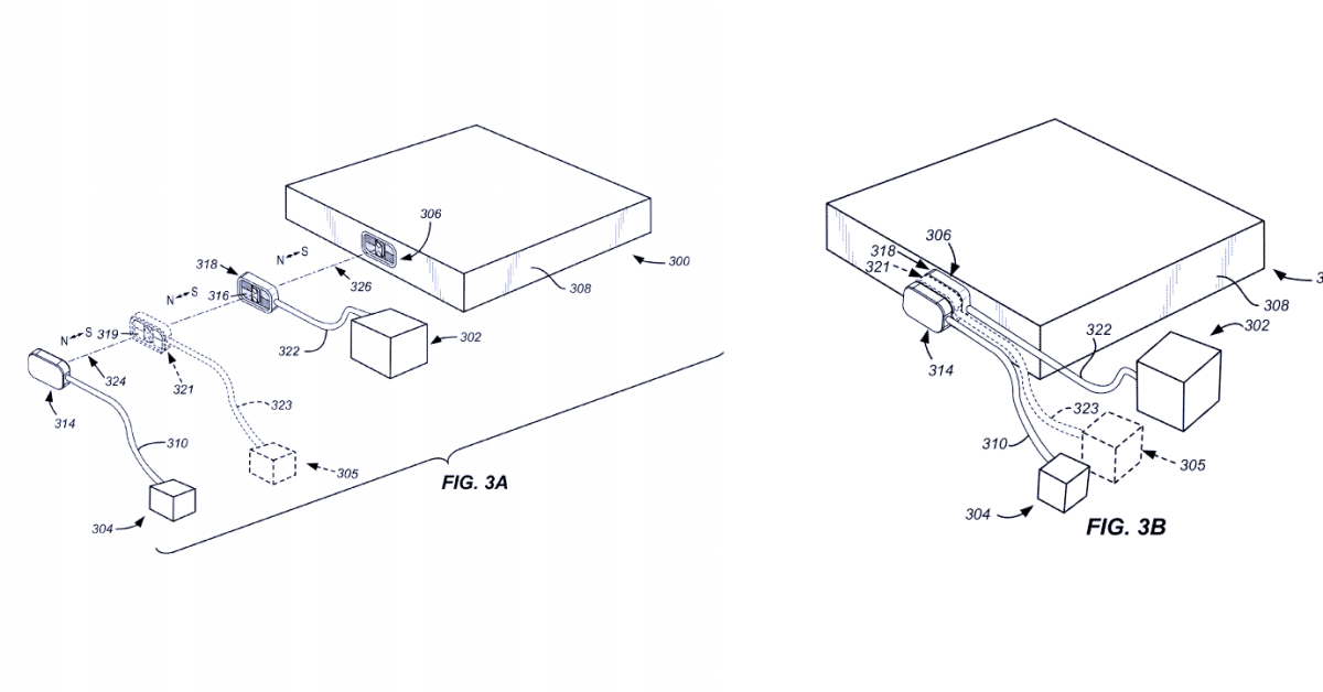

the Librem 5 v2 (2021+) is going to have a magnetic decoupling system for the usb type C connector similar to the Apple mag-safe that prevents accidental tripping and forceful-projection of your expensive-brand-new L5 v2 through the window while your children play around while you are in convergence mode trolling the forums like a bo$$ …
Well, not the right patent, but they have other magnetic plugs covered by other patents.
Close - but not quite!
