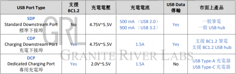

@dos, yesterday (just sharing this with you) I found official usb.org document telling myself (non-expert) that Librem 5 “definitively” and officially complies with what presented inside of it:
Therefore please take a look at slides five and six, at least, within this presentation:
And, making above short:
  • CDP (Charging Downstream Port): A USB port with enhanced charging capability, it has USB data transfer and can supply a maximum current of 1.5 A to the BC1.2 portable device.
  • DCP (Dedicated Charging Port): A CDP without USB data transfer, it can provide 4.75V~5.5V and 1.5A charging current to the BC1.2 portable device, and the DCP will connect the resistor R across D+ and D-.
Both above definitions belong to the GRL Team: https://www.graniteriverlabs.com/hs-fs/hubfs/1-10-768x240.png.
